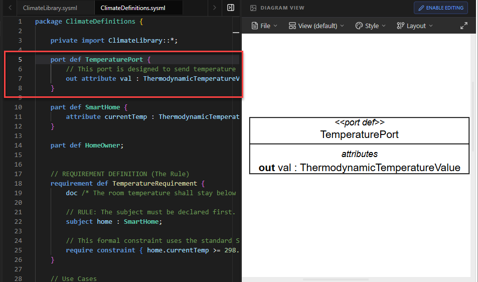

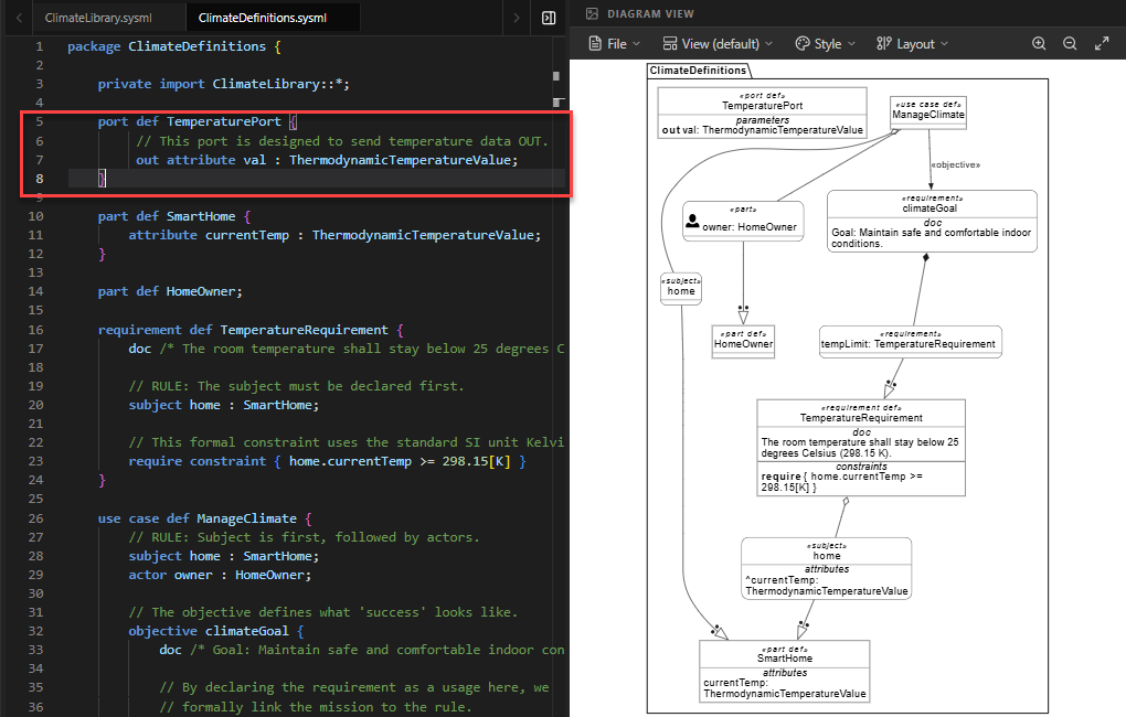

  1. Define the Port Blueprint (TemperaturePort): First, we need a standard way for components to share temperature data. We define a port def. Inside, we declare an out attribute named val. This means any part using this port will send temperature data out through it.
    port def TemperaturePort {
        // This port is designed to send temperature data OUT.
        out attribute val : ThermodynamicTemperatureValue;
    Why this matters: By defining this once, we ensure that both the Sensor and the Controller speak the same “language” when they connect.

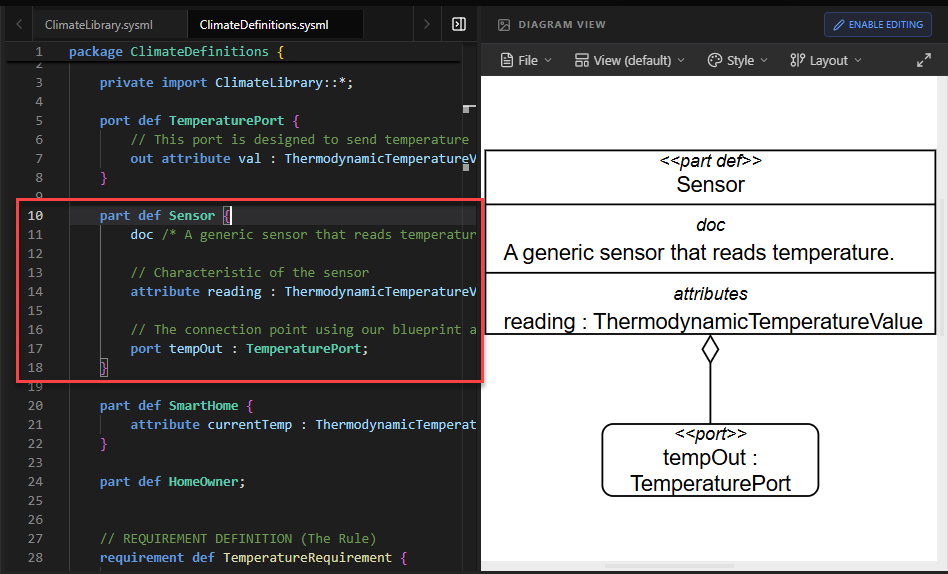

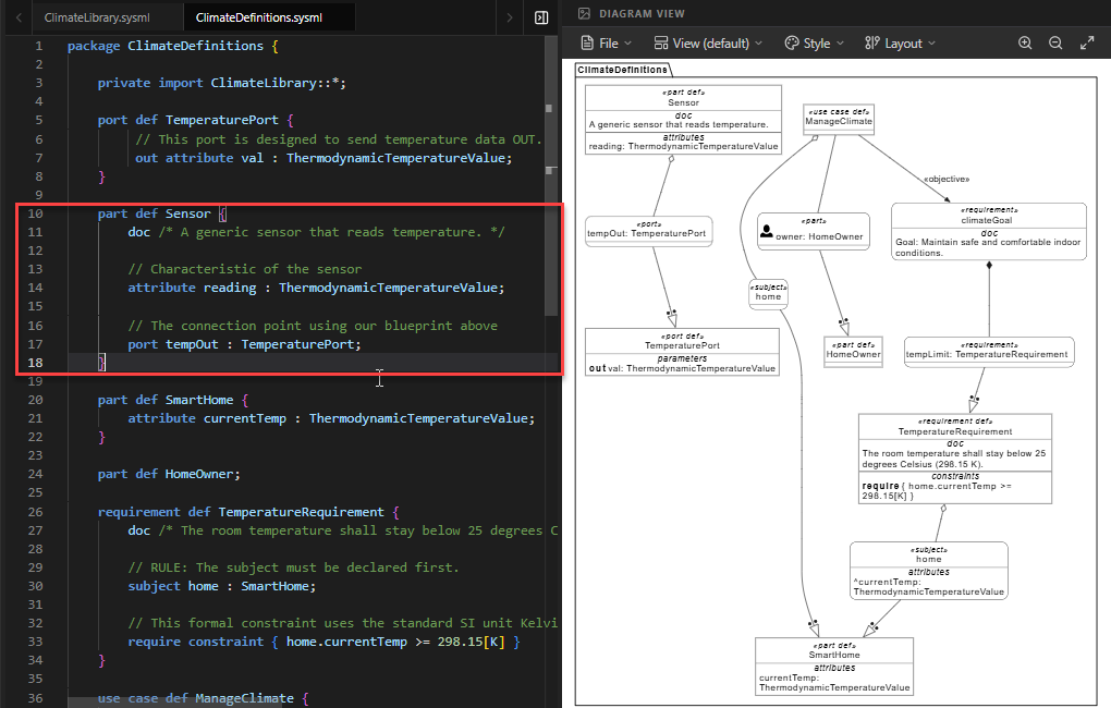

  2. Define the Sensor Blueprint (Sensor): Next, we define the Sensor part. It has two key features:
    • Attribute: reading stores the current temperature value locally.
    • Port: tempOut uses our TemperaturePort definition. This allows the sensor to broadcast its reading to other parts.
    part def Sensor {
        doc /* A generic sensor that reads temperature. */
        // Characteristic of the sensor
        attribute reading : ThermodynamicTemperatureValue;
        // The connection point using our blueprint above
        port tempOut : TemperaturePort;

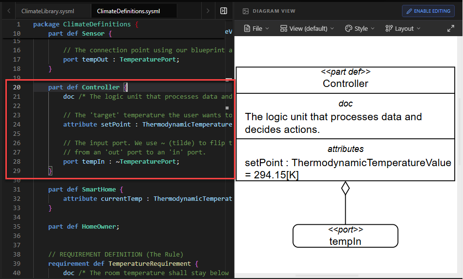

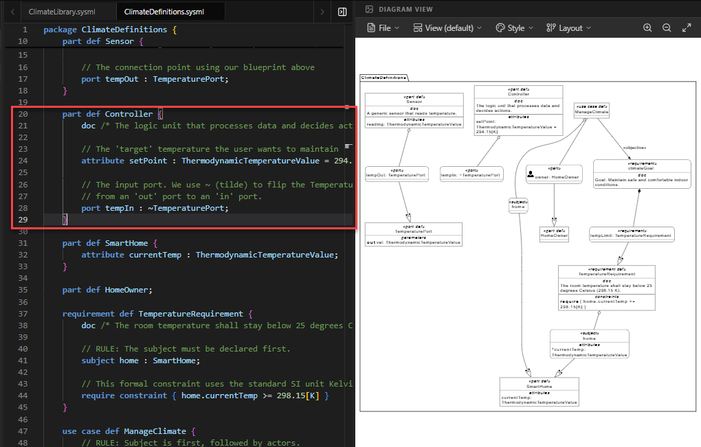

  3. Define the Controller Blueprint (Controller): The Controller is the “brain.” It needs to receive data, not just send it. Here we see the power of conjugation:
    • Attribute: setPoint defines the target temperature (defaulted to 21°C / 294.15K).
    • Port: tempIn : ~TemperaturePort. Notice the ~ (tilde). This tells SysML v2 to take the TemperaturePort (which is normally an Output) and flip it to become an Input. This allows the Controller to accept data from the Sensor.
    part def Controller {
        doc /* The logic unit that processes data and decides actions. */
        // The 'target' temperature the user wants to maintain
        attribute setPoint : ThermodynamicTemperatureValue = 294.15[K]; // 21 degC
        // The input port. We use ~ (tilde) to flip the TemperaturePort
        // from an 'out' port to an 'in' port.
        port tempIn : ~TemperaturePort;
