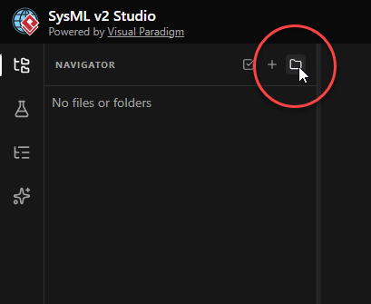

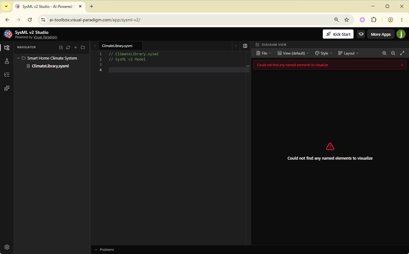

- Create the Project FolderFirst, we need a place to store our files. In the Navigator pane (usually on the left), click on New Folder.
- Name the FolderEnter Smart Home Climate System as the folder name and click Create. This folder will act as the root package for our entire project.

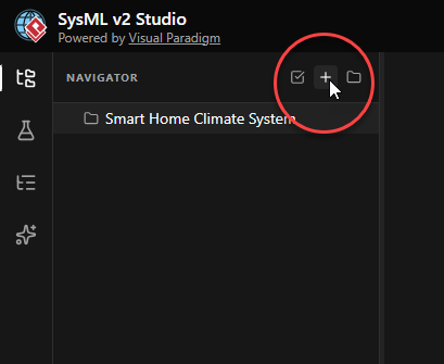

- Verify Folder CreationThis creates a new folder Smart Home Climate System in the Navigator pane. Throughout this tutorial, we will create and keep all our

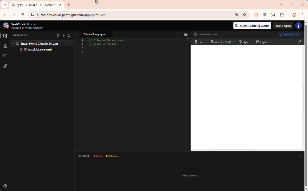

.sysmlfiles under this folder to maintain organization. - Create the Library FileLet’s create the specific file for our library. Click on the folder you just created, then click on New File at the top right.
- Name the FileEnter
ClimateLibrary.sysmlas the filename, and click Create. The.sysmlextension tells the tool that this file contains SysML v2 textual models.
- Explore the InterfaceThis opens the code editor. On the right, you will see the Diagram Viewer, which visualizes the code in real-time. Right now, both the code editor and the diagram are empty. As you type, the diagram will update automatically, helping you verify the structure.

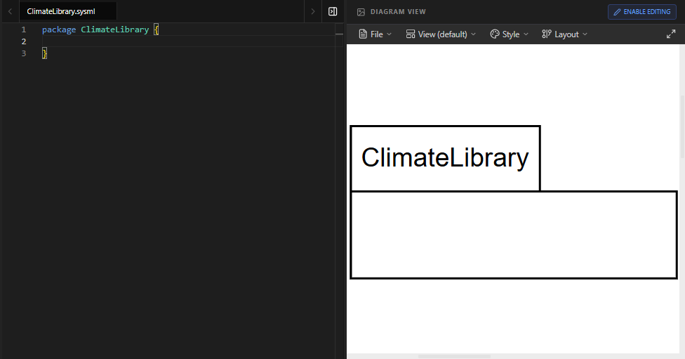

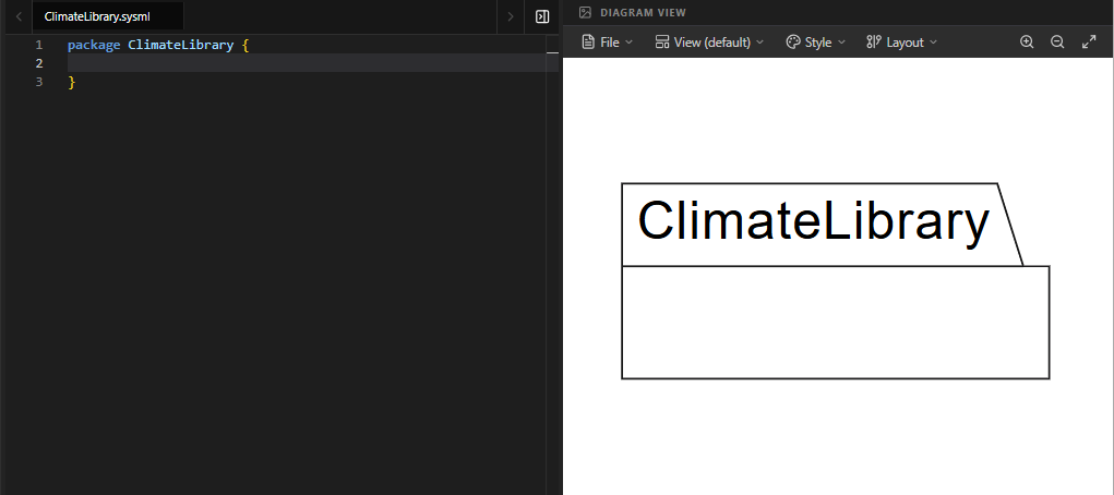

- Define the PackageLet’s start by defining the package namespace. Enter the code below into the code editor. This creates the container
ClimateLibrarythat will hold all our definitions.package ClimateLibrary { }You should see a package shape labeled “ClimateLibrary” appear in the diagram view.

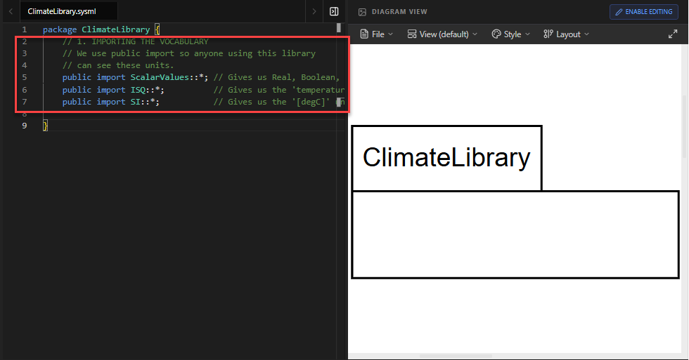

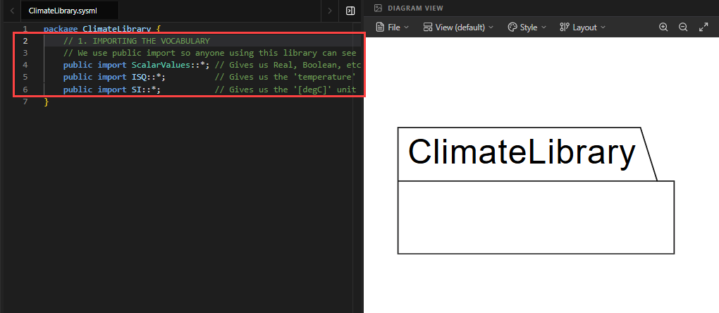

- Import Standard LibrariesNow, we need to bring in the standard vocabulary. Enter the import statements inside the package definition. These lines allow us to use standard data types and physical units without writing their full paths.
public import ScalarValues::*; // Gives us Real, Boolean, etc. public import ISQ::*; // Gives us the 'temperature' quantity public import SI::*; // Gives us the '[degC]' unit symbolCode Explanation:
public import ScalarValues::*: Makes basic data types likeRealandBooleanavailable to anyone who uses this library.public import ISQ::*: Imports physical quantities. Now we can refer to “temperature” as a concept.public import SI::*: Imports units. Now we can use symbols like[degC]or[K].
Note: The diagram view may remain unchanged for imports, as they are relationships rather than structural elements. This is normal.

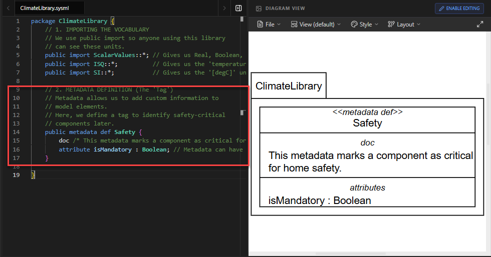

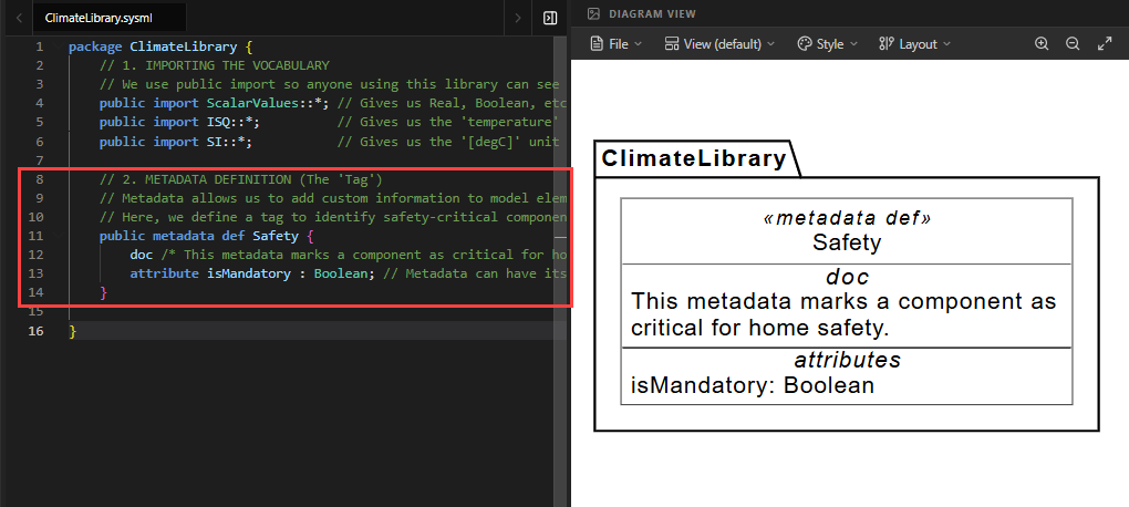

- Define Custom MetadataUnder the import statements, we will define custom metadata. Metadata allows you to attach custom “tags” or properties to any model element. In this tutorial, we define a
Safetytag to identify components that are critical for home safety later on.public metadata def Safety { doc /* This metadata marks a component as critical for home safety. */ attribute isMandatory : Boolean; // Metadata can have its own data }Code Explanation:
metadata def Safety: Defines a new type of metadata named “Safety”.doc: Adds a formal description of what this tag means.attribute isMandatory : Boolean: Adds a property to the tag. When we apply this tag to a component, we can specify whether it istrueorfalsethat it is mandatory.

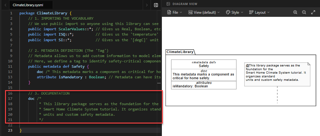

- Add Package DocumentationFinally, let’s add a formal documentation block to the package itself. This explains the purpose of the entire library to anyone who opens it.
doc /* * This library package serves as the foundation for the * Smart Home Climate System tutorial. It organizes standard * units and custom safety metadata. */Code Explanation: This
docblock is attached to theClimateLibrarypackage. It will appear in generated reports and help future engineers understand the intent of this file.

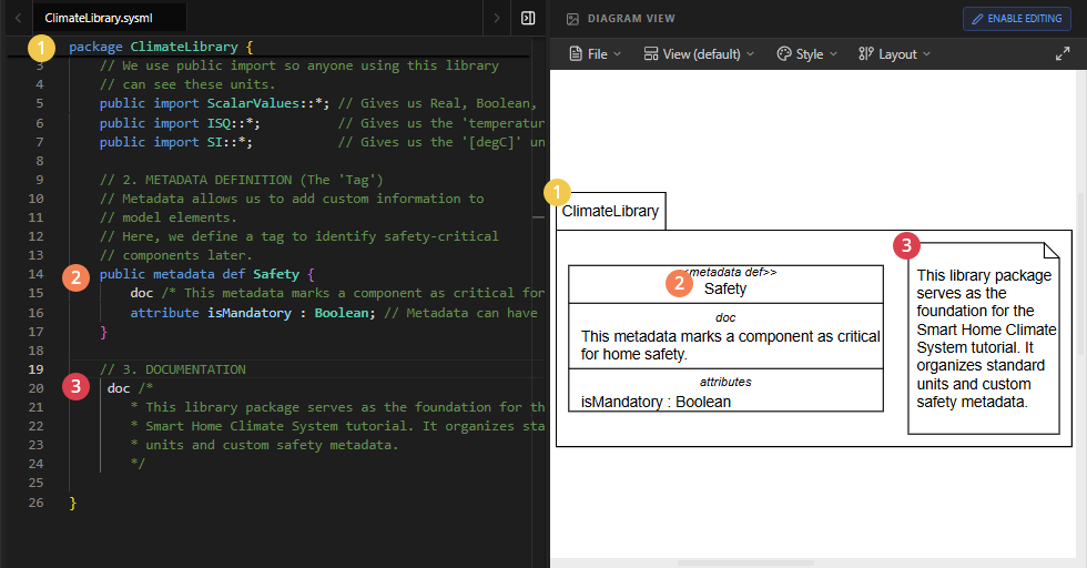

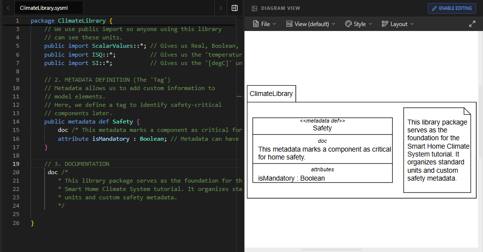

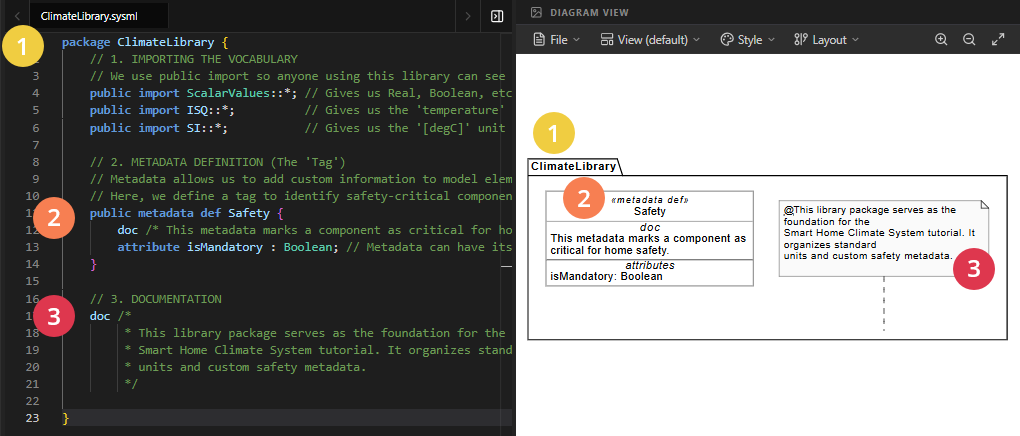

The Diagram View (A Brief Introduction)
The diagram view provides you with a graphical representation of your code, helping you understand the logical structure easier. Different parts of the code are represented by different shapes:
- The Package definition is visualized as a large container shape labeled
ClimateLibrary. - The Metadata definition
Safetyis rendered as a block-like shape, showing its attributes. - The Documentation is rendered as a note attached to the package.
Scope Based Rendering
A SysML file is formed by multiple parts. For example, you may define both requirements and use cases in one single file. The diagram view will automatically adjust to show the elements within the current scope (determined by the cursor position), helping you visualize the hierarchy and relationships without manual layout. You will learn more about this in step 2.
