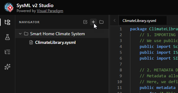

  1. Create the Definition File
    Navigate to your project workspace. Select the folder Smart Home Climate System in the project explorer. Click on New File.
    Creating a new file in Visual Paradigm
  2. Name the File
    Enter ClimateDefinitions.sysml as the filename and click Create. This file will hold the logical definitions of our system’s mission.

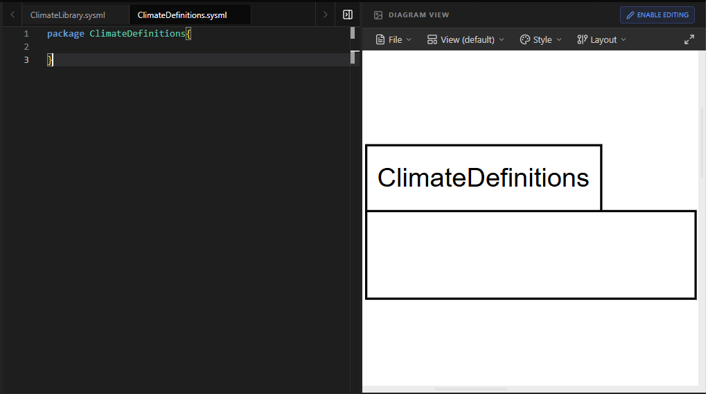

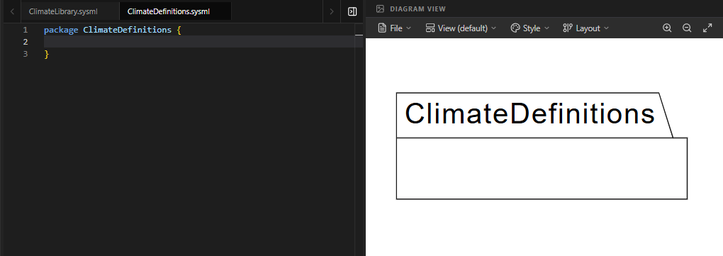

  3. Define the Package Namespace
    Every SysML model starts with a package to organize elements. Enter the following code into the editor. This creates a container for all our definitions.
    package ClimateDefinitions {
    You will see a package element appear in the diagram view, confirming the namespace is active.

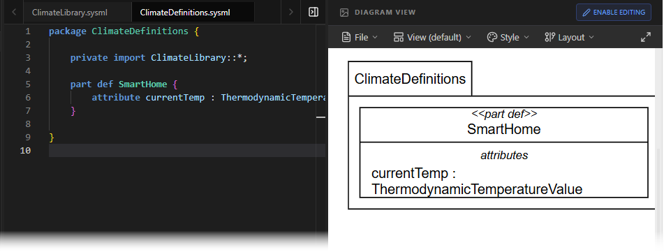

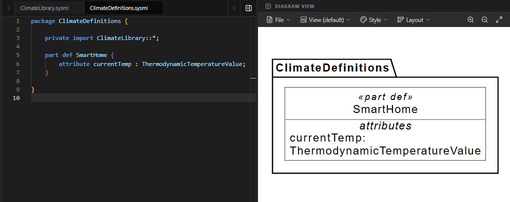

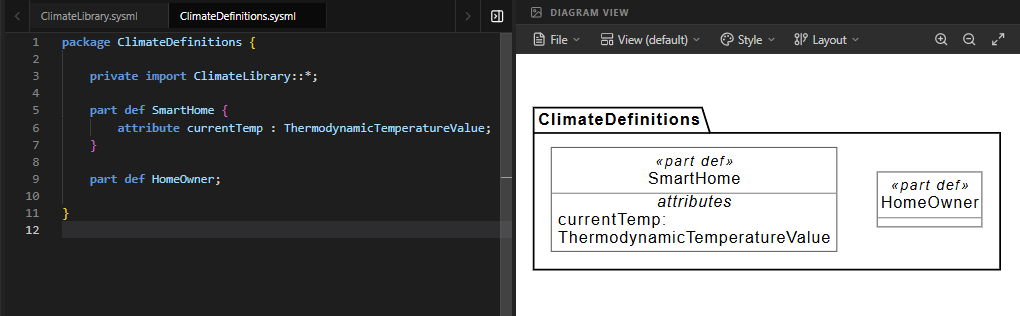

  5. Define the System Subject (SmartHome)

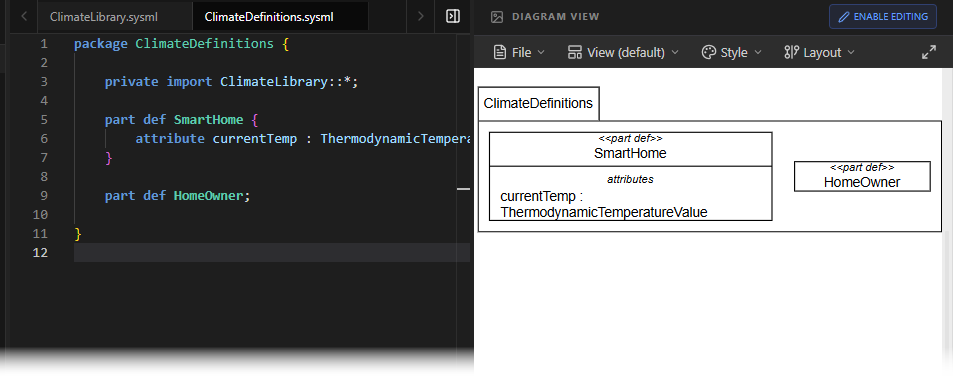

    Before we can write requirements, we must define what we are requiring. We define a part def (Part Definition) for the Smart Home. Crucially, we give it an attribute currentTemp typed by ThermodynamicTemperatureValue from our library. This allows our requirements to “see” and check the temperature.
    part def SmartHome {
        attribute currentTemp : ThermodynamicTemperatureValue;
  6. Define the Actor (HomeOwner)
    Actors are external entities. We define a simple part definition for the Home Owner. While empty now, this element allows us to link human interactions to system behaviors in Use Cases.
    part def HomeOwner;

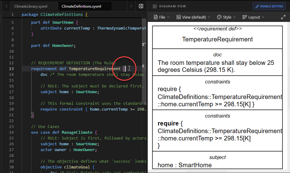

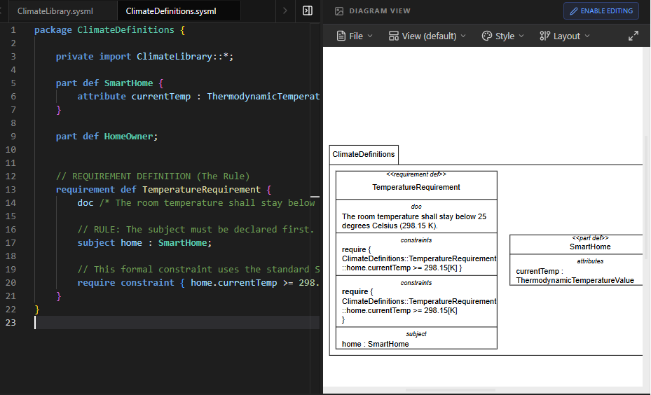

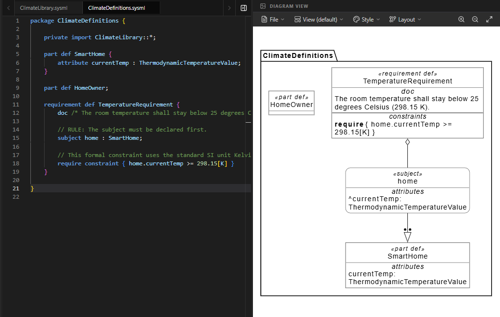

  7. Define the Requirement (TemperatureRequirement)
    This is the core rule of our system. We define a requirement def. Note the structure:
    • doc: The human-readable “shall” statement.
    • subject home : SmartHome: We explicitly state that this requirement applies to an instance of SmartHome named home.
    • require constraint: The mathematical logic. We assert that home.currentTemp must be less than or equal to 298.15 Kelvin (which is 25°C).
    requirement def TemperatureRequirement {
        doc /* The room temperature shall stay below 25 degrees Celsius (298.15 K). */
        // RULE: The subject must be declared first.
        subject home : SmartHome;
        // This formal constraint uses the standard SI unit Kelvin [K].
        require constraint { home.currentTemp <= 298.15[K] }

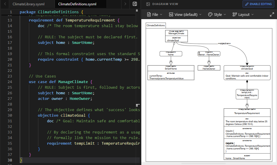

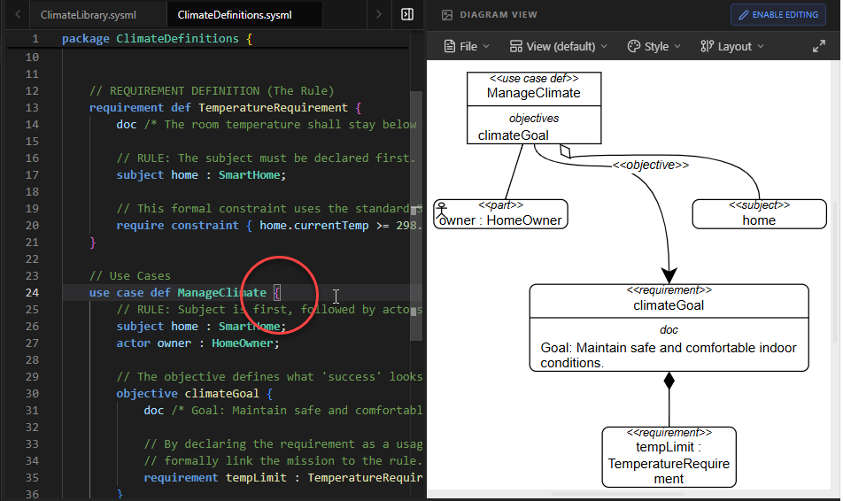

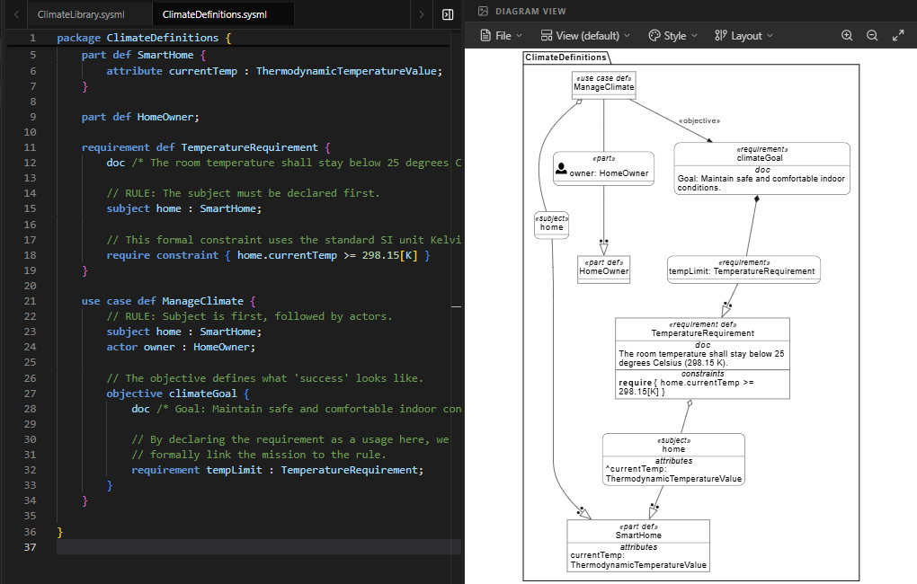

  8. Define the Use Case (ManageClimate)
    Finally, we define the high-level mission. A Use Case aggregates requirements and actors to describe a complete scenario.
    • Subject & Actor: We declare the SmartHome as the subject and HomeOwner as the actor interacting with it.
    • Objective: Inside the objective block, we define what success looks like. We include the TemperatureRequirement as a usage (tempLimit). This formally links the high-level goal (“Manage Climate”) to the specific technical rule (“Stay below 25°C”).
    use case def ManageClimate {
        // RULE: Subject is first, followed by actors.
        actor owner : HomeOwner;
        // The objective defines what 'success' looks like.
        objective climateGoal {
            doc /* Goal: Maintain safe and comfortable indoor conditions. */
            // By declaring the requirement as a usage here, we
            // formally link the mission to the rule.
            requirement tempLimit : TemperatureRequirement;

    // 5. USE CASE DEFINITION (The Mission Goal)

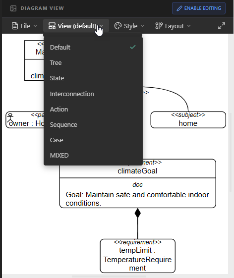

Switching Diagram Views

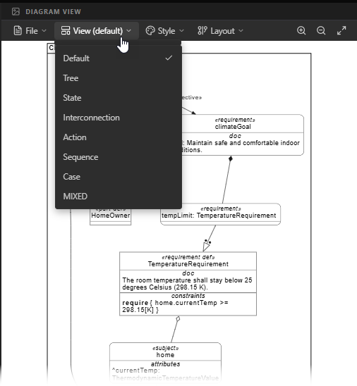

The SysML v2 Diagram Viewer is versatile and offers multiple ways to visualize your model. Since a single file can encompass different aspects of system architecture (such as structure, behavior, or requirements), you can select the view that best suits your current task.
How to Switch Views:
  1. Look for the View dropdown menu located at the top of the Diagram Viewer panel.
  2. Click to expand the list and select the view that matches your needs. Common options include:
    • Default: A general-purpose structural view.
    • Tree: Shows the hierarchical containment of elements.
    • Case: Optimized for viewing Use Cases and Requirements (ideal for this step).
    • Interconnection: Best for visualizing part connections and ports.
    • State / Action / Sequence: Used for behavioral modeling in later steps.
    • Mixed: Combines multiple diagram types.
Troubleshooting Empty Diagrams:
Note that not every view is compatible with every type of code. For example, selecting a “Sequence” view while editing a static “Requirement” may result in an empty diagram. If you find that the diagram is blank or not showing what you expect, it is likely that you have selected a view that does not support the current code context. Simply switch back to Default or Case view to resolve this.
