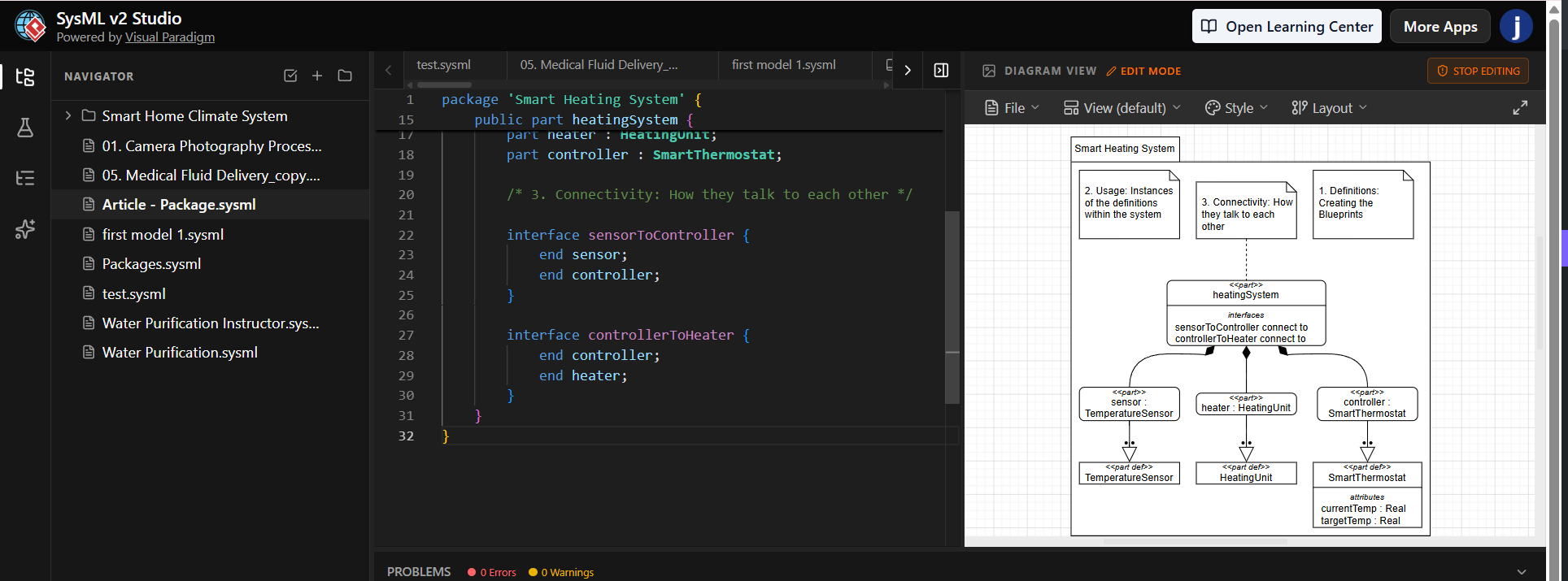

SysML v2 Package Diagram (by VP SysML v2 Studio)
In SysML v2, textual modeling is the primary authoring method. Below is the complete KerML-based package definition for the Smart Heating System:
SysML V2 – Text Notation
package 'Smart Heating System' {

Deep Dive: Core Elements & Key Concepts Highlights
The textual syntax above may look concise, but each keyword carries specific semantic weight. Below is a comprehensive breakdown tailored for beginners:
🔹 package
A namespace container that groups related modeling elements. It prevents naming collisions, establishes scope, and enables modular organization. Packages can be nested, imported, and reused across projects.
🔹 part def (Part Definition)
Represents a type blueprint. It answers the question: What kind of component is this? A definition does not occupy memory or represent a physical object; it establishes shared characteristics, constraints, and potential behaviors that multiple instances can inherit.
🔹 part (Part Usage)
Represents a concrete instance within a specific context. When you write part heater : HeatingUnit, you are declaring that the current system contains one physical or logical heater conforming to the HeatingUnit blueprint. Usage allows you to bind definitions to a specific architectural scope.
🔹 attribute
Defines data properties held by a part. In SysML v2, attributes are strongly typed. ScalarValues::Real indicates a floating-point numeric value. Attributes are essential for parametric analysis, simulation, and runtime state tracking.
🔹 interface
Replaces the legacy SysML v1 concept of ports and connectors. An interface explicitly declares a communication channel or relationship between two part usages. The end keyword binds the interface to specific parts, ensuring unambiguous data flow and command routing.
🔹 public
Controls visibility. Public elements are accessible to external packages, enabling cross-project reuse and library distribution. Omitting visibility modifiers typically defaults to package-private or local scope, depending on the modeling environment.
